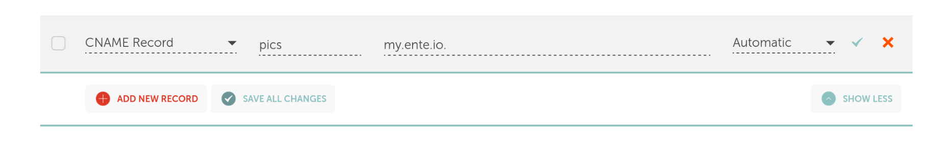

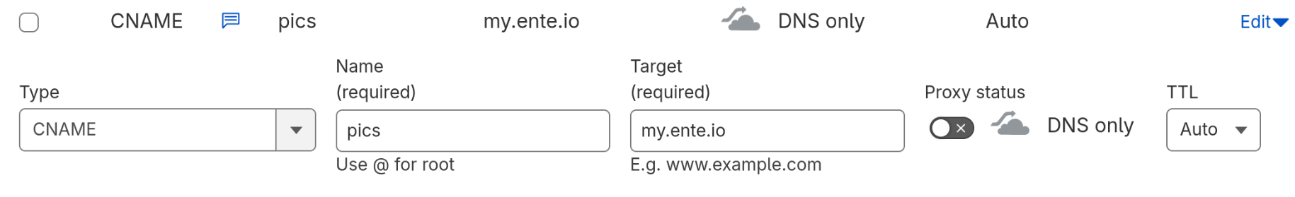

As concrete examples, here is how this step would look for Cloudflare:
Note that orange proxy option is off. And here is how it would look for Namecheap:
NOTE
The examples are using "pics" as the subdomain, but that's just an example, you can use anything you like (or use "@" if you'd like to use the root domain itself).
The time it takes for DNS records to update is dependent on your DNS provider. Usually the changes should start reflecting within a few minutes, and should almost always reflect within an hour.

.If you're using Cloudflare DNS, make sure that the "Orange" proxy status toggle is off, and the Proxy status is the "Grey" DNS only.
